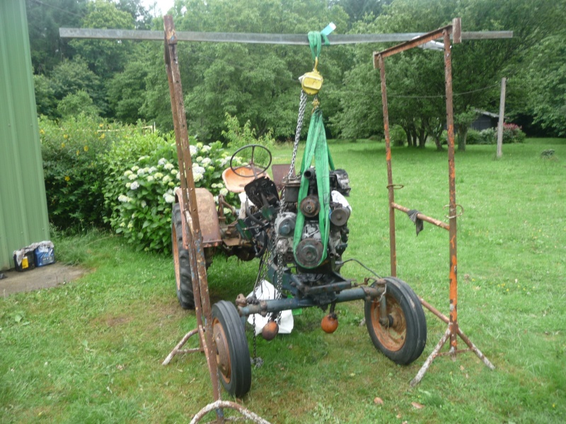

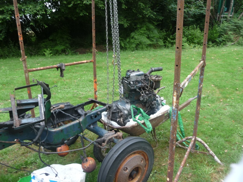

BONSOIR
TOUT EST PRES POUR SORTIR LE MOTEUR
TRACTEUR A RANGER DANS LE HANGAR
JE PREVOIS 2 ETAIS-1 POUTRE-2 SANSGLES-1 PALAN 500KG
DEPOSE SAMEDI MATIN

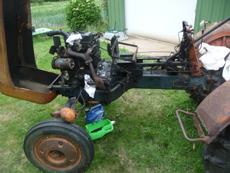

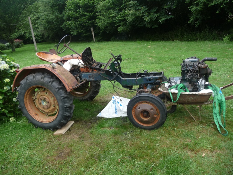

BONSOIR
MOTIVE CE SOIR=MOTEUR DEPOSE ET RANGE DANS LE HANGAR
DEGRAISSAGE DU CHASSIS
PUPU29Image

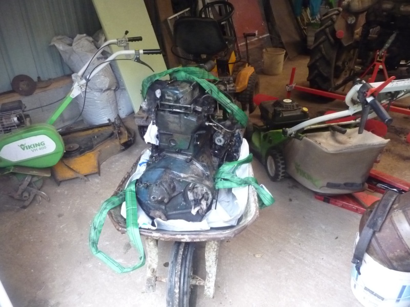

BONSOIR
MOTIVE=MOTEUR DEPOSE ET STOCKE
NETTOYAGE CHASSIS COMMENCE
PUPU29Image
